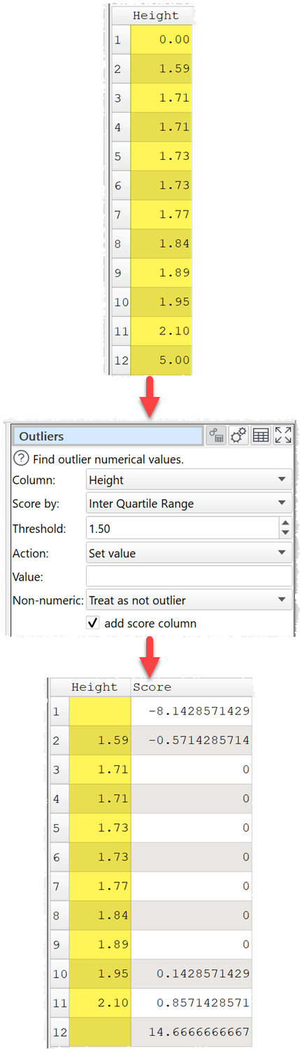

Set outliers empty based on quartiles and add a column with the outlier score:
Remove outliers using IQR example

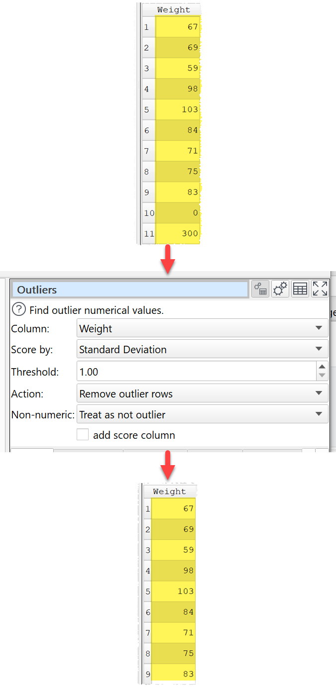

Remove rows with values that are more than 1 Standard Deviation from the mean:
Remove outlier rows

oInter Quartile Range scores values on how far they are above Q3 or below Q1 as proportion of the Inter Quartile Range. For example:
▪A value 2 IQRs above Q3 scores 2.0.
▪A value 1 IQR below Q1 scores -1.0.
▪A value between Q3 and Q1 scores 0.0.
oStandard Deviation scores values on how many deviations they are from the average (mean). This is also known as a Z-score. For example:
▪A value 2 Standard deviations above the average scores 2.0.
▪A value 1 Standard deviations below the average scores -1.0.
•Any score that is greater than Threshold or less than -Threshold is considered an outlier. E.g. if the threshold is 1.5 then values that scores more than 1.5 or less than -1.5 are considered outliers. The corresponding upper and lower 'fence' values are shown in the Info tab.

oRemove outlier rows: Rows with outlier values are removed.

oSet value: Outlier values are changed to the value provided in the Value field.

•Check add score column if you want to add an extra column with the outlier scoring.
