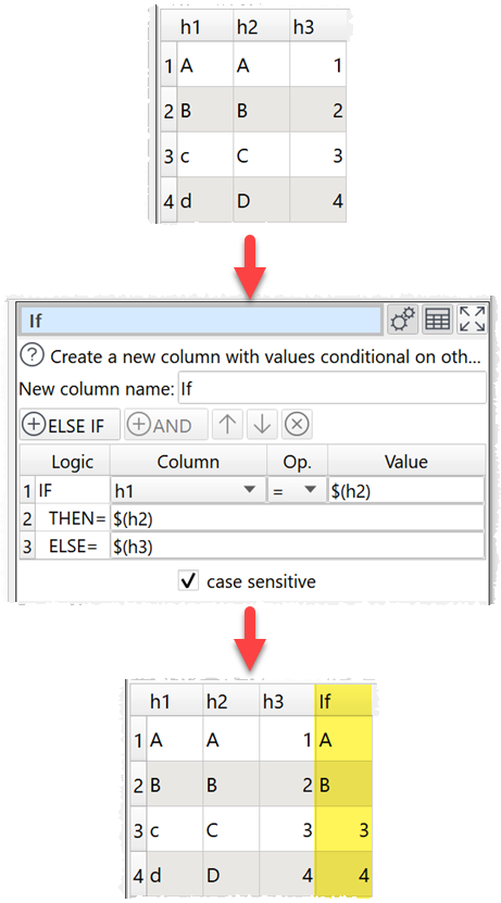

Click the add-button@1xELSE IF button to add a new IF/ELSE IF..THEN condition.
Click the add-button@1xAND'button to add an AND to the selected IF/ELSE IF..THEN.
Click the remove-button@2x button to delete the selected IF/ELSE IF..THEN/AND.
The Logic column shows the type of row.
Set Value to the value you wish to compare.
The IF, THEN and ELSE values can use column variables, as in the second example above.
You can simulate OR with multiple IF statements. For example:
 IF x = 1 OR y = 2
    THEN 3
  Is equivalent to:
 IF x = 1
    THEN 3
 ELSE IF y = 2
    THEN 3
