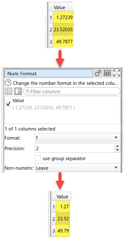

•Set Format to the new number format (see below).
•For the e, E, and f formats, Precision represents the number of digits after the decimal point. For the g and G formats, Precision represents the maximum number of significant digits (trailing zeros are omitted). For the s format Precision is ignored. The following number formats are supported:

f |
Format as [-]9.9. E.g. 1234567.89 is shown as 1234567.89. |

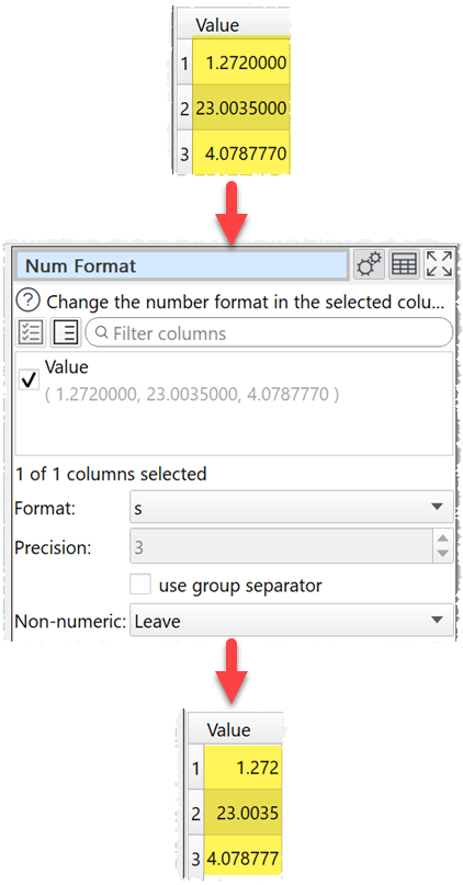

s |
The shortest accurate representation for the given number without exponents. E.g. 1234567.00 is shown as 1234567. |
