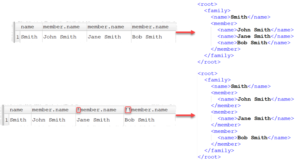

Exclamation marks at the start of column names are removed from name tags when output to XML. This can be useful when you want duplicate tag names with the same parent.

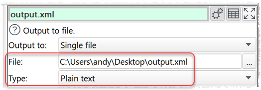

If you need really fine grained control over the XML output, you can:
•output the XML to a file
•read the file back in as plain text
•apply transforms
•write it back out as plain text
