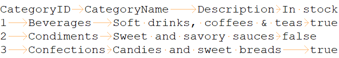

For example:
Is output with Delimiter set to Tab (\t) and Quoting set to Never as:
