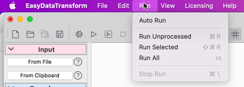

Run>Run Unprocessed: Run processing on any items that are not already processed.
Run>Run Selected: Run processing on one or more selected items, even if they are already processed. Any upstream or downstream items are also processed.
Run>Run All: Run processing on all items, even if they are already processed. This is provided for completeness, but you should usually use one of the above 2 options, for efficiency.
Run processing menu
