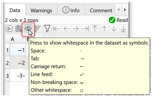

12. Click the eye icon in the Right pane to show whitespace in the data.

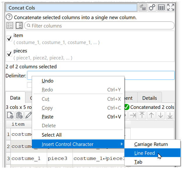

30. Use the right click menu to insert control characters into a text option for a transform.

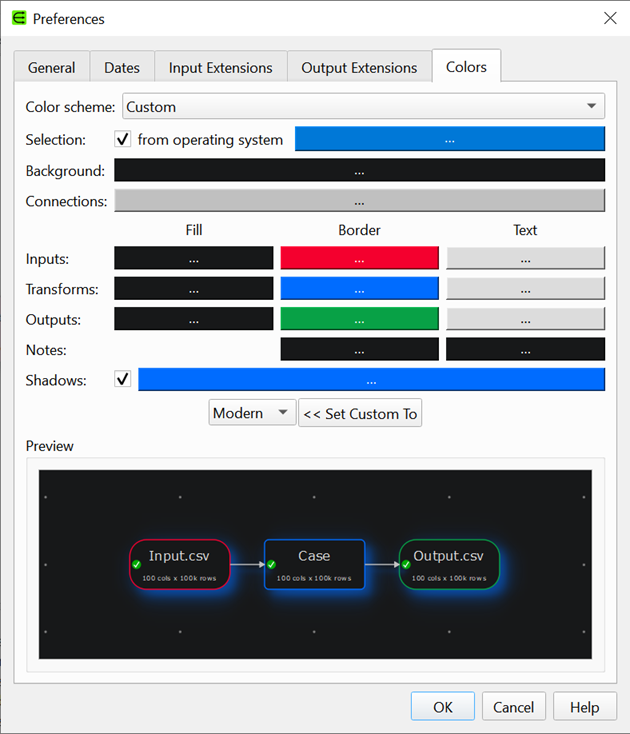

32. Change the Center pane color scheme in the Colors tab of the Preferences window.
