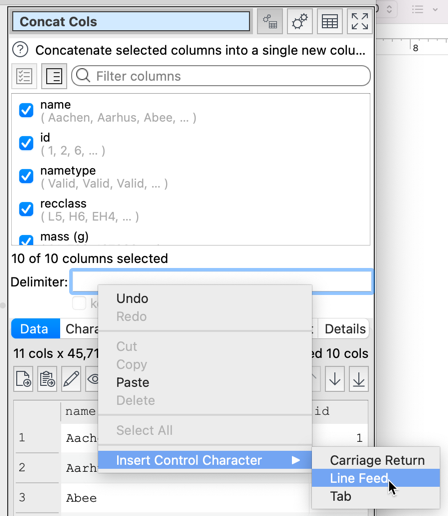

33. Use the right click menu to insert control characters into a text option for a transform.
Insert control characters.
