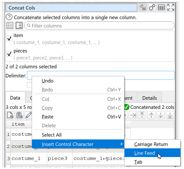

33. Use the right click menu to insert control characters into a text option for a transform.

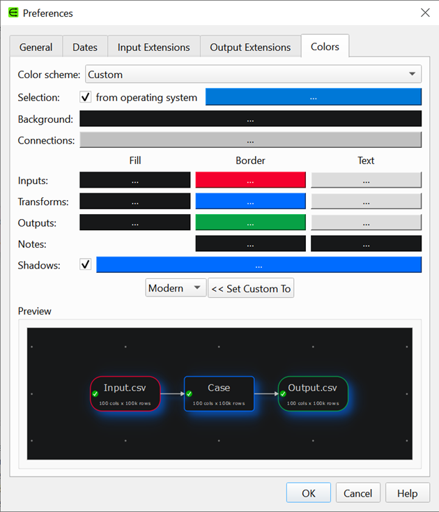

35. Change the Center pane color scheme in the Colors tab of the Preferences window.
