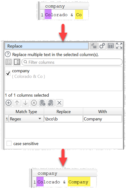

Replace a whole word using a regular expression (\b=word boundary):

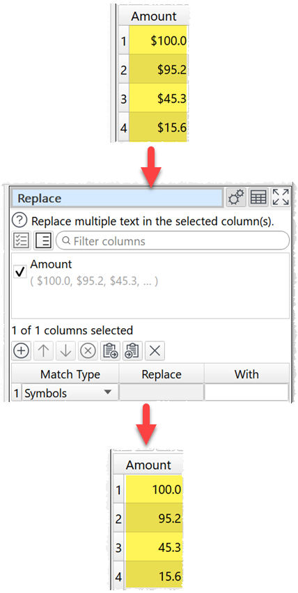

Remove symbols:
