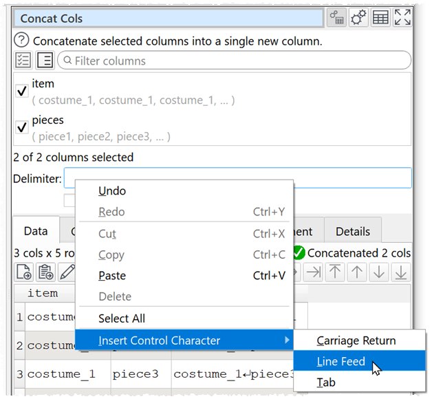

35. Use the right click menu to insert control characters into a text option for a transform.

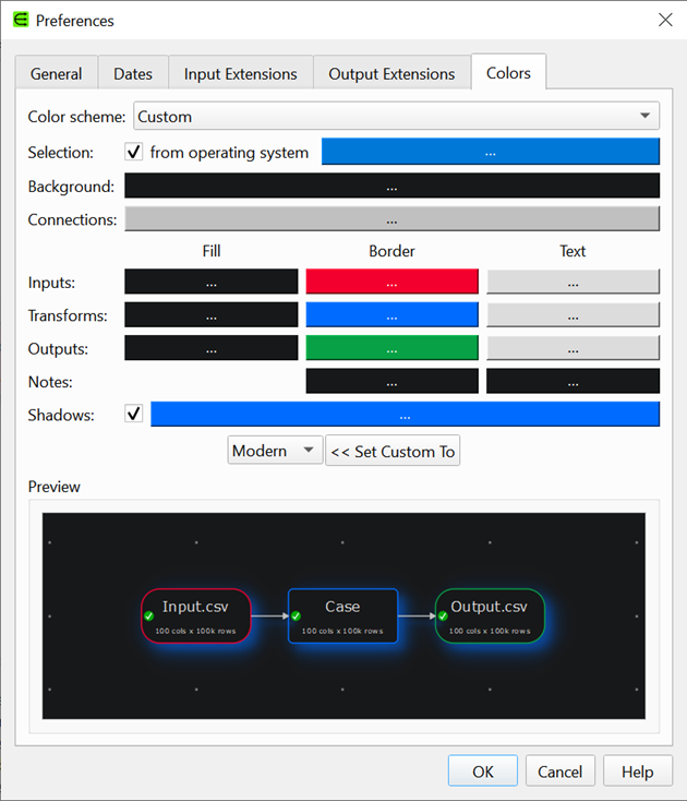

38. Change the Center pane color scheme in the Colors tab of the Preferences window.

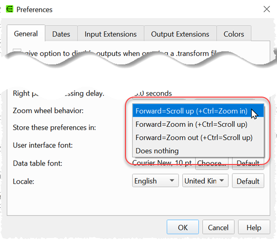

41. Set the Center pane mouse wheel behavior in the Preferences window.
