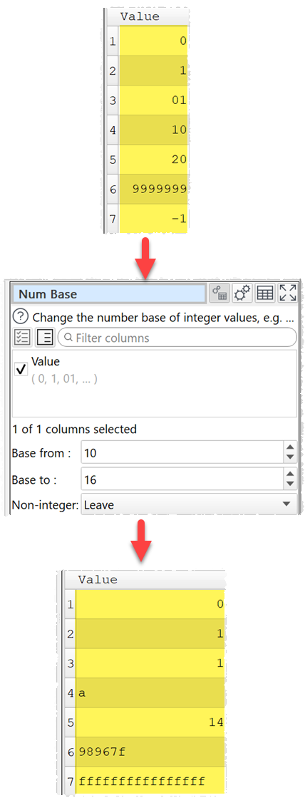

Convert from decimal (base 10) to hexadecimal (base 16):
Change from decimal (base 10) to hexadecimal (base 16)

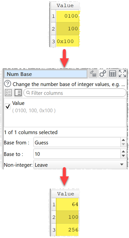

Convert from guessed base to decimal (base 10):
Change from guessed base to decimal (base 10)
•Check the column(s) you wish to convert.
•Set Base from to the base of the current values. If you set it to Guess, it will guess the base for each column by looking at some of the values, Numbers starting with 0x (e.g. 0x123) are assumed hexadecimal (base 16). The base guessed in output in the Info tab.

•Negative numbers are represented using unsigned values (e.g. twos complement for binary) if Base to is anything other than 10.
