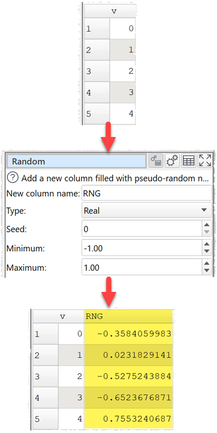

Adds a new column, filled with pseudo-random numbers.
Add a new column of random real values between -1 and +1:
pseudo-random number generator
•Set Type depending on whether you wish to generate Real (floating point) or Integer (whole number) values.
•Set Seed to the seed value used by the pseudo-random generator algorithm.
•Set Minimum to the minimum value you want to generate. The value may be equal to minimum, but not less.
•Set Maximum to the maximum value you want to generate. The value may be equal to maximum, but not more.
•The numbers output are a sequence of pseudo-random numbers based on the Seed value.
•The same sequence is always output for the same options.
•The default Seed value is based on the system clock when the transform was first created.

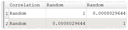

•You can use the Correlate transform to check sets of random numbers are not correlated. This show the very low correlation between 2 sets of 1,000,000 values between 0.0 and 1.0 generated by Random using seeds 0 and 1:
correlating pseudo random numbers
