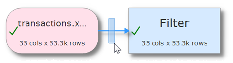

•Select the connection.
•Choose the new transform from the Left pane or using the right click menu.

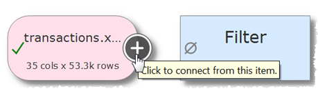

•Hover over the start item.
•Click the '+' that appears.

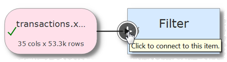

•Hover over the end item
