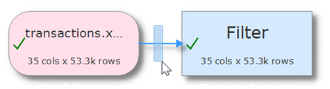

When you select an input or transform item and add a transform or output item, connections to the currently selected item(s) are added automatically.
•Click on the connection; or
•Click and drag a box over any part of the connection. This may be easier than clicking the connection when you are zoomed back.

•Select the connection.
•Choose the new transform from the Left pane or using the right click menu.

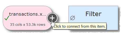

•Hover over the start item.
•Click the '+' that appears.

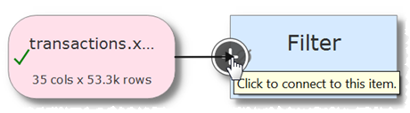

•Hover over the end item
