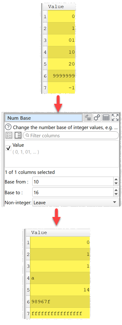

Change the number base of integer values, e.g. decimal to hexadecimal.
Convert from decimal (base 10) to hexadecimal (base 16):

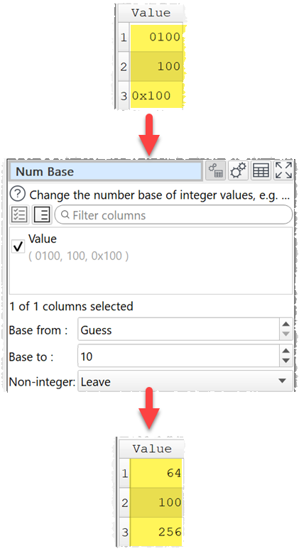

Convert from guessed base to decimal (base 10):
•Check the column(s) you wish to convert.
•Set Base from to the base of the current values. If you set it to Guess, it will guess the base for each column by looking at some of the values, Numbers starting with 0x (e.g. 0x123) are assumed hexadecimal (base 16). The base guessed in output in the Info tab.
•Set Base to to the base wanted.
•The values to be converted should be integers (whole values) without group separators (e.g. no commas or decimal points).
•If Base from and Base to are the same, no change is made.
