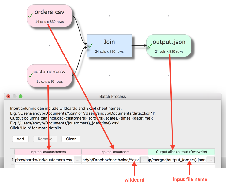

join multiple files
Note:
All input and output items must have an alias.
An output item can't have the same alias as another output or input item.
Output items with Write mode=Disabled are not shown.
Input
/Users/andy/Documents/*.csv
/Users/andy/Documents/d?.csv
Note:
If there is more than 1 input column that specifies multiple files or sheets, then an output will be created for each possible permutation of input files/sheets in the row. E.g. 3 input files from column 1 x 4 sheets from column 2 = 12 outputs to process.
Excel sheet names are not case sensitive.
You cannot use wildcards for folder names.
Batch processing will ignore files in sub-folders.
All the files input to an input item or output from an output item should be the same file type as the original.
Output variable
Meaning
{<input alias>}
If input alias 'orders' is using file
{date}
2020_04_18
{time}
15_21_56_599
{datetime}
2020_04_18_15_21_56_599
