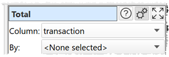

Totalling the transaction column:

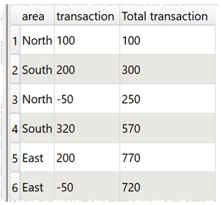

Gives a running total of transactions:

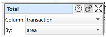

Totalling the transaction column by area:

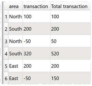

Gives a separate running total for each area:
•Set Column to the column you want to total.
•Set By to a column if you want a separate running total per value in that column. Leave as <None selected> if you only want a single running total.
•The By column takes account of case and whitespace in values.
