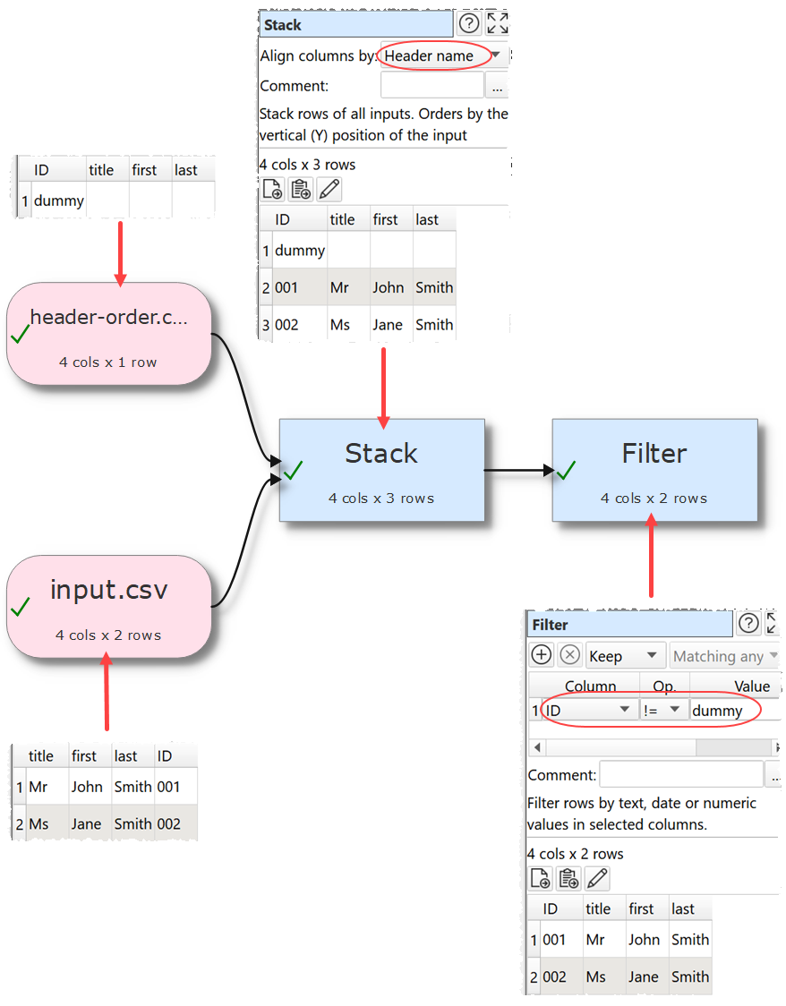

Same columns with the same names, but in a different order
If columns are in different orders in different input files (e.g. the "id" column in the first column in input 1 and the second column in input 2) you need to sort the input columns into a standard order before applying other transforms. You can so this using the Stack transform with Align columns by set to Header name. Stack your input under a dataset with columns in the correct order. You can use a Filter to remove any unneeded rows after the stacking.
change-header-order-v163
