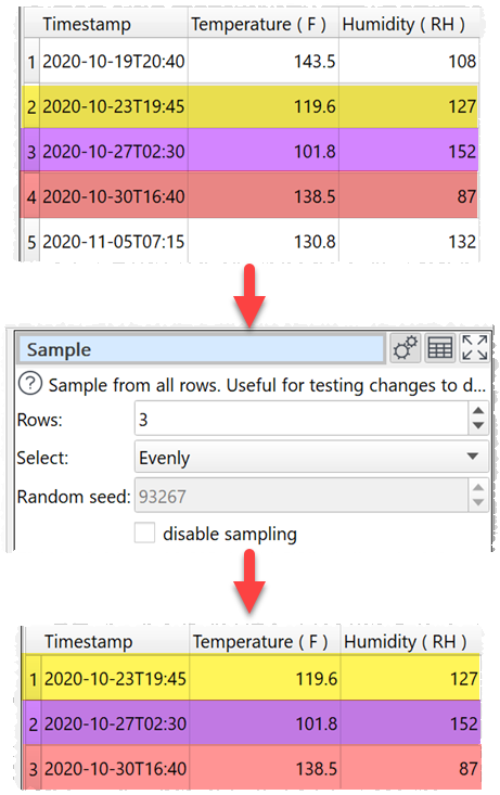

Selects a subset of rows from the input.
Sample 3 rows from 5:
how to sample rows example
Set Rows to the number of rows you want to output. If it is the same or greater than the number of rows in the input, then the input will be unaffected.
Set Select depending on how you want the rows sampled.
Check disable sampling to turn off sampling. If sampling is disabled, the transform does nothing.
