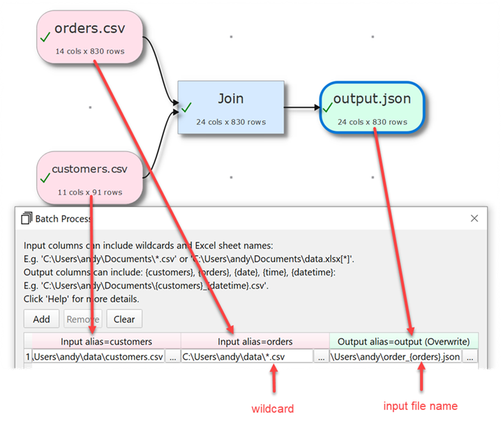

To apply the current .transform file to multiple input files select File>Batch Process... . The Batch Process window will appear with a column for each input item and a column for each output item. The Alias for each item is displayed in the column header.
join multiple files

Input
C:\Users\andy\Documents\*.csv
Note:
Output variable
Meaning
{<input alias>}
If the input with alias 'orders' is using file 'C:\Users\andy\Documents\orders_2020.csv' then '{orders}' is replaced with value 'orders_2020'.
If the input with alias 'orders' is using file 'C:\Users\andy\Documents\orders_2020.xlsx' with sheet 'Sheet1' then '{orders}' is replaced with value 'orders_2020_Sheet1'.
{date}
2020_04_18
{time}
15_21_56_599
{datetime}
2020_04_18_15_21_56_599
