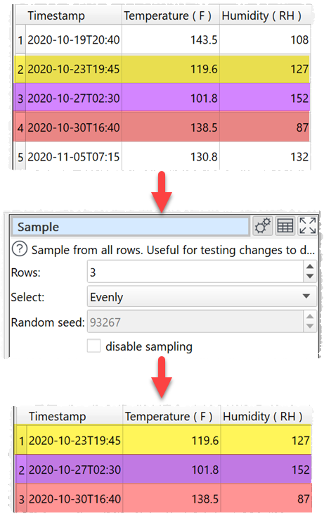

Selects a subset of rows from the input.
Sample 3 rows from 5:
•Set Rows to the number of rows you want to output. If it is the same or greater than the number of rows in the input, then the input will be unaffected.
•Set Select depending on how you want the rows sampled.
