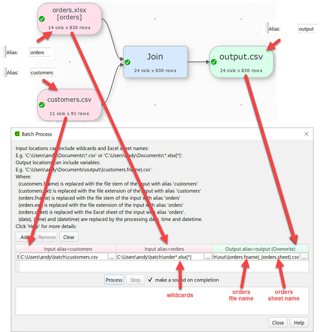

Batch processing
join multiple files

Input
/Users/andy/Documents/*.csv
/Users/andy/Documents/d?.csv
Note:
In the output column(s) you can use the following variables to create your output file name:
Output variables
Meaning
{<input alias>.fname}
If the input with alias 'orders' is using file
{<input alias>.ext}
The extension of the input file being processed in the column with the corresponding alias. Does not include the '.'.
{<input alias>.sheet}
The sheet of the input file being processed in the column with the corresponding alias (Excel only).
{<input alias>}
The name of the input file (plus an underscore and the sheet name, if an Excel file) being processed in the column with the corresponding alias.
{date}
2020_04_18
{time}
15_21_56_599
{datetime}
Date/Time processing was carried out in year_month_day_hours_minutes_seconds_milliseconds format
2020_04_18_15_21_56_599

You can write to multiple sheets of an Excel file, for example:
batch process Excel sheets
