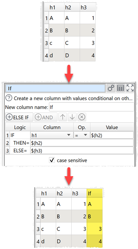

If the h1 value is 1 use the value of the h2 column, otherwise use the value of h3 column:

•Click the add-button@1xELSE IF button to add a new IF/ELSE IF..THEN condition.
•Click the add-button@1xAND'button to add an AND to the selected IF/ELSE IF..THEN.
•Click the remove-button@2x button to delete the selected IF/ELSE IF..THEN/AND.
 IF x = 1 OR y = 2
    THEN 3
  Is equivalent to:
 IF x = 1
    THEN 3
 ELSE IF y = 2
    THEN 3
