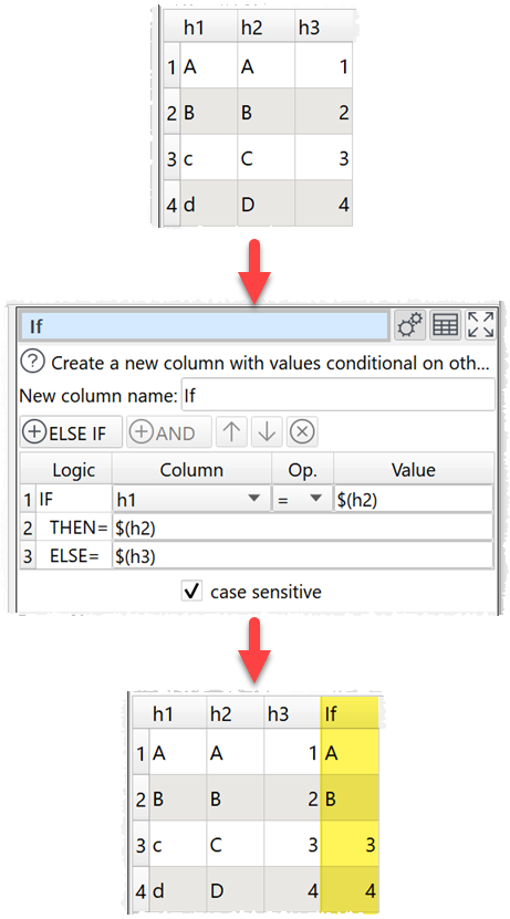

If the h1 value is 1 use the value of the h2 column, otherwise use the value of h3 column:
•Click the
ELSE IF button to add a new IF/ELSE IF..THEN condition.
•Click the
AND'button to add an AND to the selected IF/ELSE IF..THEN.
•Click the
button to delete the selected IF/ELSE IF..THEN/AND.
