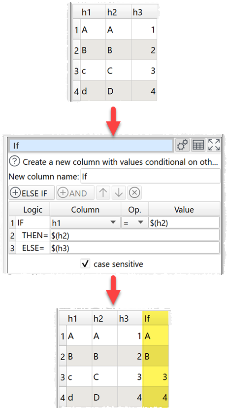

If the h1 value is 1 use the value of the h2 column, otherwise use the value of h3 column:

Click the add-button@1xELSE IF button to add a new IF/ELSE IF..THEN condition.
Click the add-button@1xAND'button to add an AND to the selected IF/ELSE IF..THEN.
Click the remove-button@2x button to delete the selected IF/ELSE IF..THEN/AND.
The Logic column shows the type of row.
Set Value to the value you wish to compare.
The IF, THEN and ELSE values can use column variables, as in the second example above.
You can simulate OR with multiple IF statements. For example:
 IF x = 1 OR y = 2
    THEN 3
  Is equivalent to:
 IF x = 1
    THEN 3
 ELSE IF y = 2
    THEN 3
Comparisons of text are whitespace sensitive. You can use Whitespace to remove whitespace before filtering and Replace to get of other unwanted characters (e.g. whitespace inside the text).
