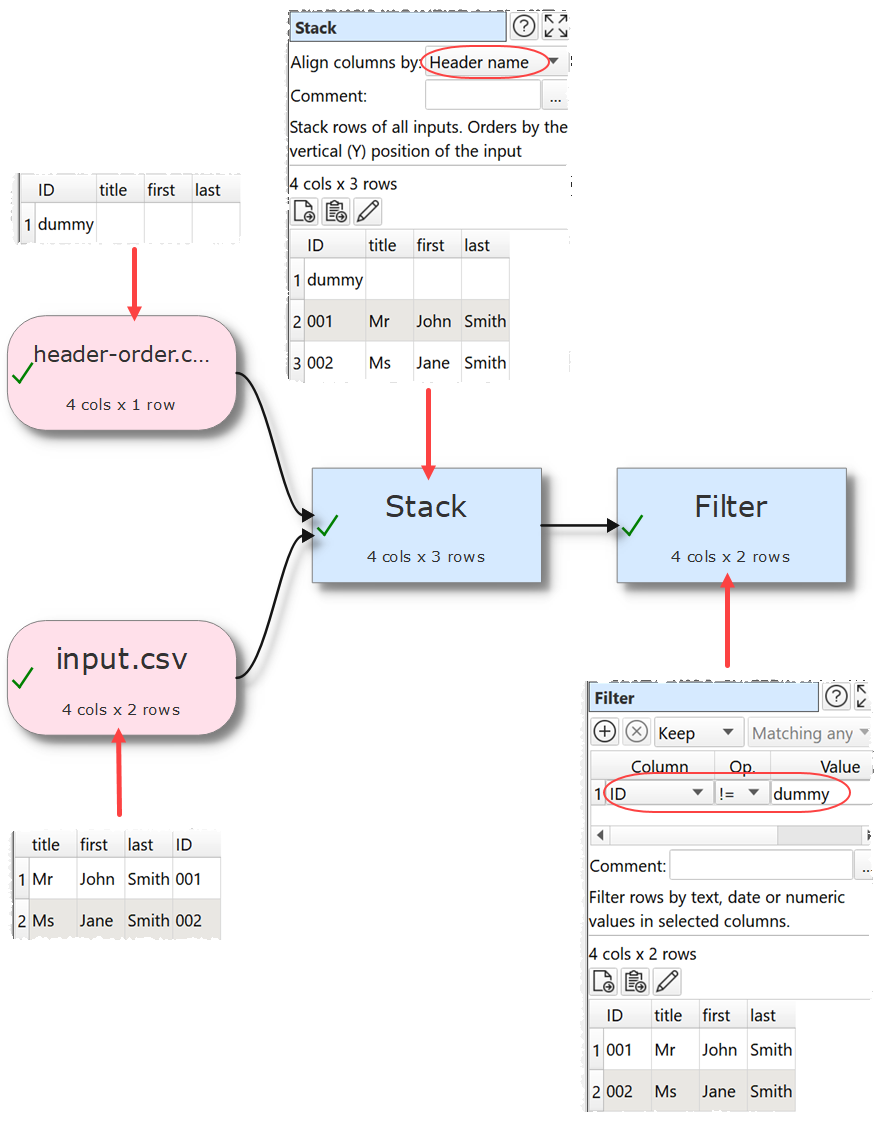

Easy Data Transform references columns by their position (e.g. 3rd column from the left) not their column name. So differences in column names (e.g. first column is called "id" in input 1 and "UniqueID" in input 2) are not generally an issue. But you need to be careful if you are using the Stack transform with Align columns by set to Header name, as this will reorder columns by name. If you want to always output the same column names, regardless of the input column names, you should use a Rename Cols transform to set the names.
If columns are in different orders in different input files (e.g. the "id" column in the first column in input 1 and the second column in input 2) you need to sort the input columns into a standard order before applying other transforms. You can so this using the Stack transform with Align columns by set to Header name. Stack your input under a dataset with columns in the correct order. You can use a Filter to remove any unneeded rows after the stacking.
