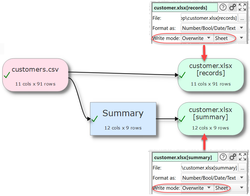

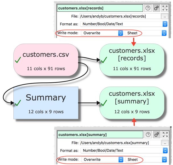

To write to multiple sheets (tabs) of the same Excel file you need to set the Write mode of each output item to Overwrite/Sheet (to clear the sheet first) or Append (to add to existing sheet data).
If you set the Write mode to Overwrite/File for an item then the write will remove existing sheets.
