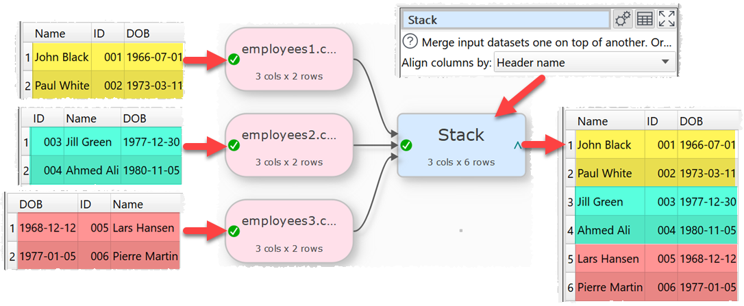

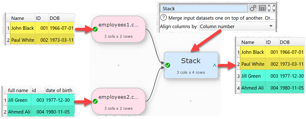

Select Align columns by to Header name if you want line up column values by header name (e.g. the 'id' column in input 1 with the 'id' column in input 2) and Column number to align by the column number (e.g. the first column of input 1 with the first column of input 2). The headers will be matched in order:
The stacking order depends on the vertical (Y-axis) position of the inputs.
Stack merges datasets one on top of the other (vertically). To merge datasets side-by-side (horizontally) use Join.
If you align by Column number the header of the first input is used.
