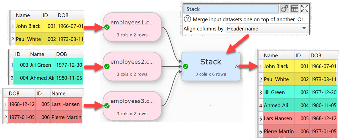

Stack

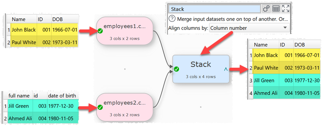

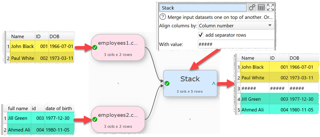

Stack 2 employee datasets with a separator row:
stack with separator
One or more.
Select Align columns by to Header name if you want line up column values by header name (e.g. the 'id' column in input 1 with the 'id' column in input 2) and Column number to align by the column number (e.g. the first column of input 1 with the first column of input 2). The headers will be matched in order:
Check add separator rows to extra rows to separate the inputs. The value entered for With value is used for each column of the separator rows.
The stacking order depends on the vertical (Y-axis) position of the inputs.

If you align by Column number the header of the first input is used.
