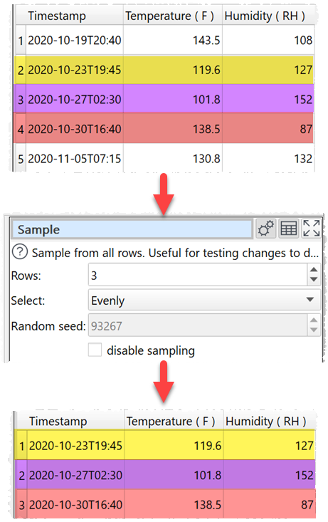

Selects a subset of rows from the input.
Sample 3 rows from 5:
how to sample rows example
•Set Rows to the number of rows you want to output. If it is the same or greater than the number of rows in the input, then the input will be unaffected.
•Set Select depending on how you want the rows sampled.
•Check disable sampling to turn off sampling. If sampling is disabled, the transform does nothing.
•If you set Select to Randomly (for quality) or Randomly (for speed), rows will be selected using a pseudo-random number generator, initialized with Random seed. Changing the seed will change the rows sampled.
•With the same Random seed and the same Select value you should get the same random sampling, even across Windows and Mac versions of Easy Data Transform.
•Random (for speed) is significantly faster than Randomly (for quality), but the results may be less random.
•If you are transforming a large dataset, then you can use Sample to test a small subset.
