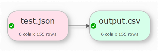

convert CSV to JSON
4.Select File>Batch Process.
batch convert CSV to JSON
6.Press the Process button. A .csv file will now be created for each .json file in the folder. In the example above the {test} file name variable will be replaced by the file name of the input file with alias test (if you just output to output.csv then you would be continually overwriting the same file).

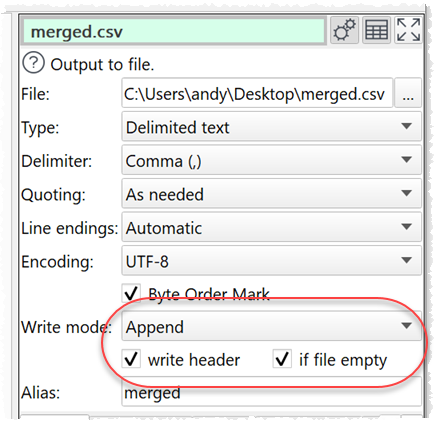

4. In the Right pane set Write Mode to Append and check write header and if empty. This ensures that only one header will be written, rather than one for every input file.

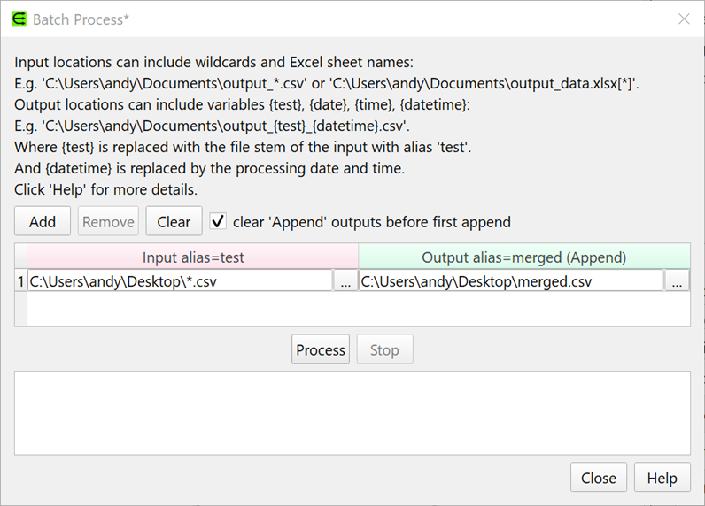

5.Select File>Batch Process.
change the input .csv file name to *.csv, so that all the .csv files in that folder will be processed.
Check clear 'Append' outputs before first append so that any existing data in the output file is cleared before we start appending to it.

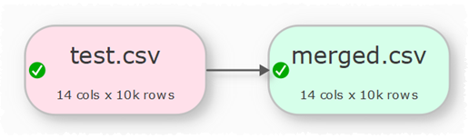

join multiple CSV
