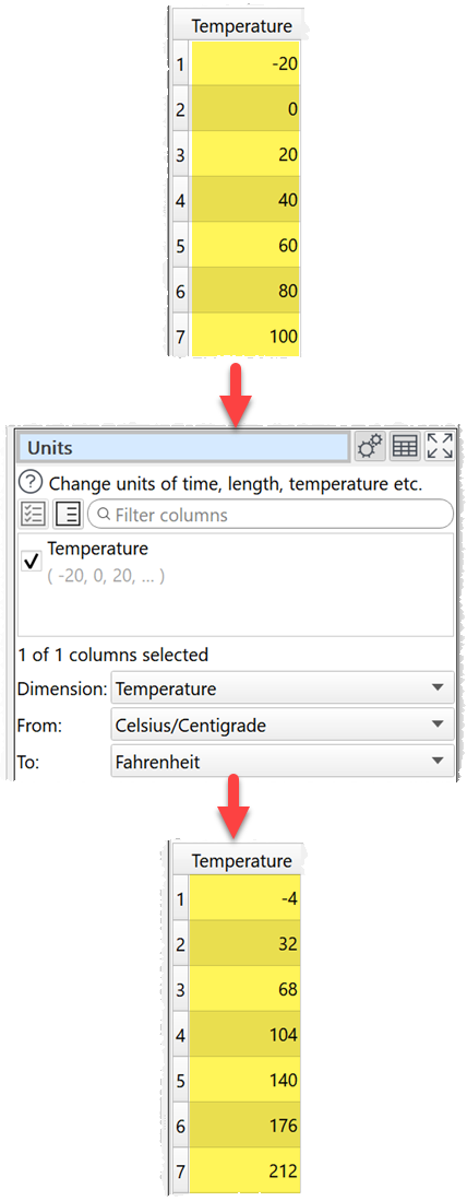

How to convert temperature units example.
Set Dimension to the dimensions of the units you wish to convert.
Set From to the units you wish to convert from.
Set To to the units you wish to convert to.
The locale  is used to decide how the number is represented (e.g. decimal separators).
