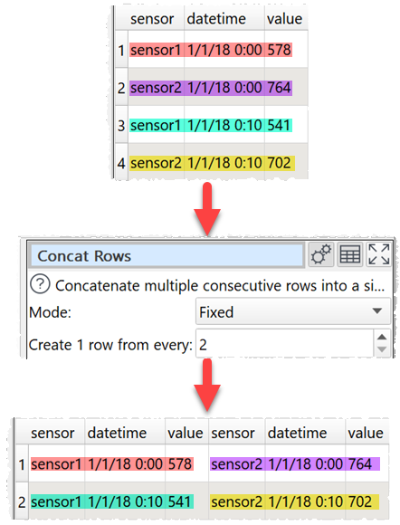

Concatenate every 2 rows to 1:

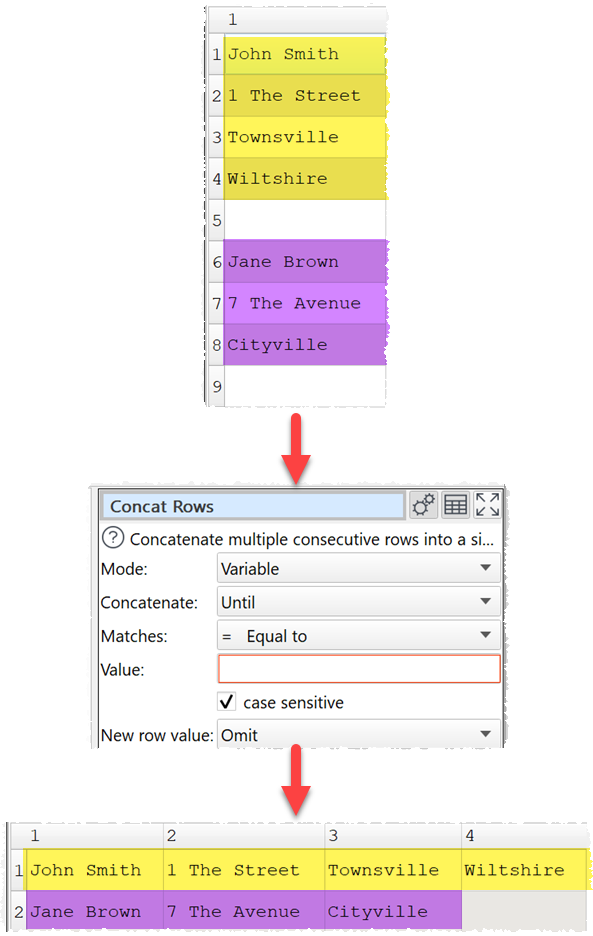

Concatenate rows until each empty row:

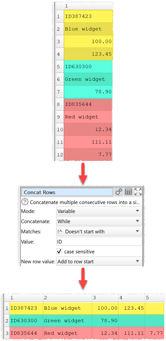

Concat rows while value not starting with 'ID':
•Set Mode to Fixed or Variable depending on whether you want to use a fixed or variable number of rows from the current dataset to make each new row.
•Set Create 1 row from every to N, to concatenate every N rows into 1 row (Mode=Fixed only).
•Set Concatenate to Until or While to keep concatenating until/while a match is found for Matches and Value (Mode=Variable only).
•Check case sensitive to use case sensitive matching for text (Mode=Variable only).
•Set New row value depending on what you want to do with the value that denotes a new row (Mode=Variable only).
