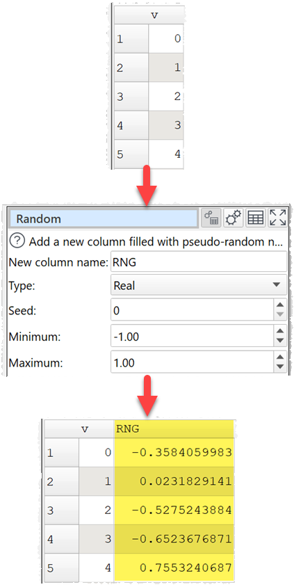

Add a new column of random real values between -1 and +1:

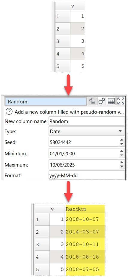

Add a new column of dates randomly chosen from 1st Jan 2000 and 10th June 2025 (inclusive):

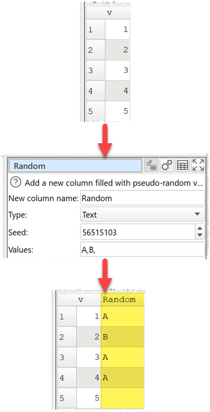

Add a new column of text values randomly chosen from 'A', 'B' or empty:
•Set Type depending on whether you wish to generate Real (floating point), Integer (whole number), Date or Text values.
•Set Seed to the seed value used by the pseudo-random generator algorithm.
•Set Minimum to the minimum value you want to generate. The value may be equal to minimum, but not less. For Type is Real, Integer or Date only.
•Set Maximum to the maximum value you want to generate. The value may be equal to maximum, but not more. For Type is Real, Integer or Date only.
•Set Format to the date format. For Type is Date only.
•Set Values to a comma delimited list of values to choose from. Empty and duplicate values are allowed. Values may not contain commas. For Type is Text only.

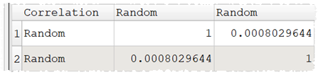

•You can use the Correlate transform to check sets of random numbers are not correlated. This show the very low correlation between 2 sets of 1,000,000 values between 0.0 and 1.0 generated by Random using seeds 0 and 1:
