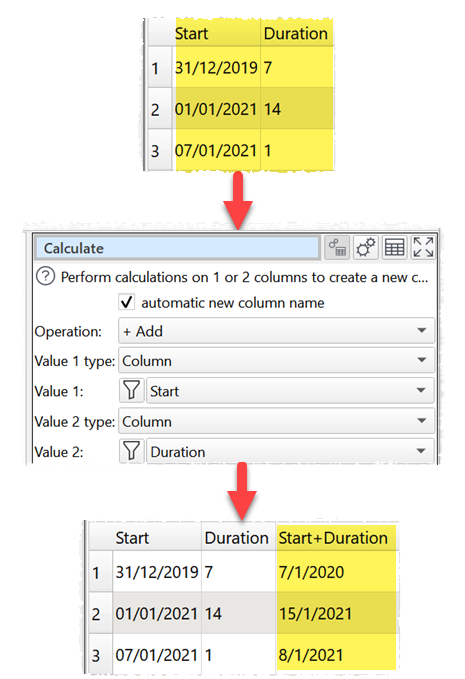

•Set Value 1 type depending on whether you wish to use a single value or a column of values for the first value.
•Set Value 1 to the first column of values or constant value you wish to operate on.
Operation
Value 1
Value 2
+ Add
Number
Number
Numerical addition.
1.2 + 3 = 4.2
Date
Integer number
Adds days to the date.
31/01/2021 + 7 = 07/02/2021

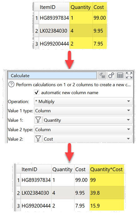

* Multiply
Number
Number
Numerical multiplication.
1.2 * 3 = 3.6

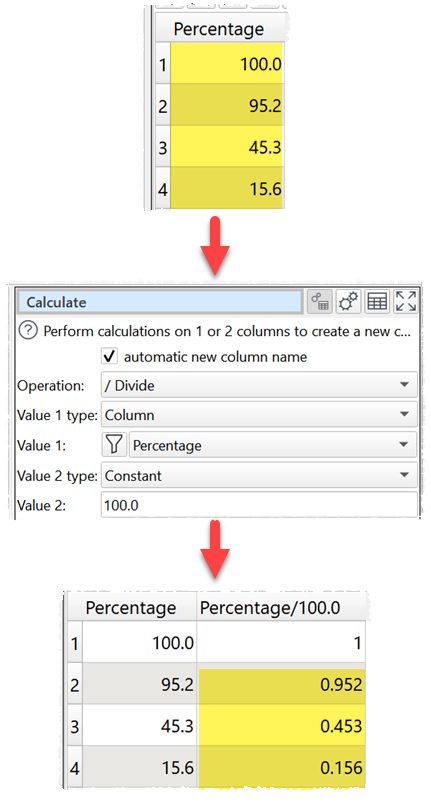

/ Divide
Number
Number
Numerical division.
1.2 / 3 = 0.4

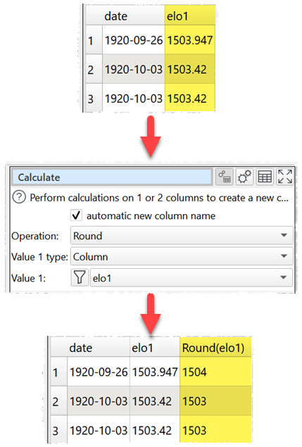

Round
Number
N/A
Round to the nearest integer.
Round( 1 ) = 1
Round( -1.2 ) = -1
Round( 1.5 ) = 2
