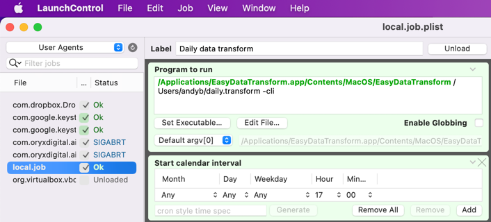

You can use launchd, which is part of macOS (but not very friendly). Or you can use any number of third party scheduler applications , such as LaunchControl.
You can change the input and output file names through the command line interface. Add -cli to close Easy Data Transform after the job is finished.
