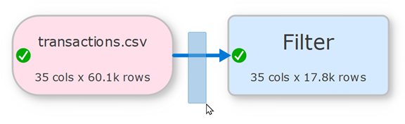

To select a connection
•Click on the connection; or
•Click and drag a box over any part of the connection. This may be easier than clicking the connection when you are zoomed back.
select-connection

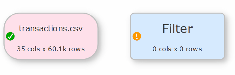

To delete a connection
To delete a connection:
•Select the connection.
•Select Edit>Delete (or click the Delete tool bar button).
Easy Data Transform will try to remember columns when an item is disconnected and reconnected. But it is generally better not to disconnect an item, unless you have to.
•If you want to change an input file, do it by selecting the input and clicking on '...' in the Right pane, rather than disconnecting the input and connecting a new one.
•If you want to add a new transform between 2 already connected items, you can do it without disconnecting (see below).
