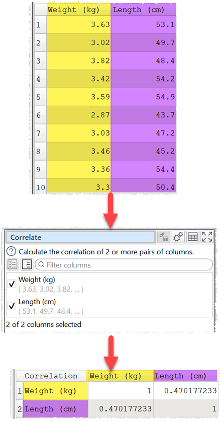

Calculates the Pearson correlation coefficient of values in 2 or more pairs of columns.
Calculate the correlation between specimen weight and length:
Pearson correlation example
