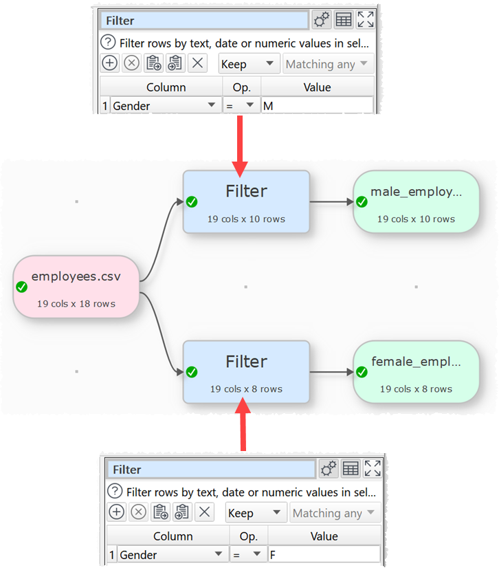

Example 1: Simple splitting
simple file splitter

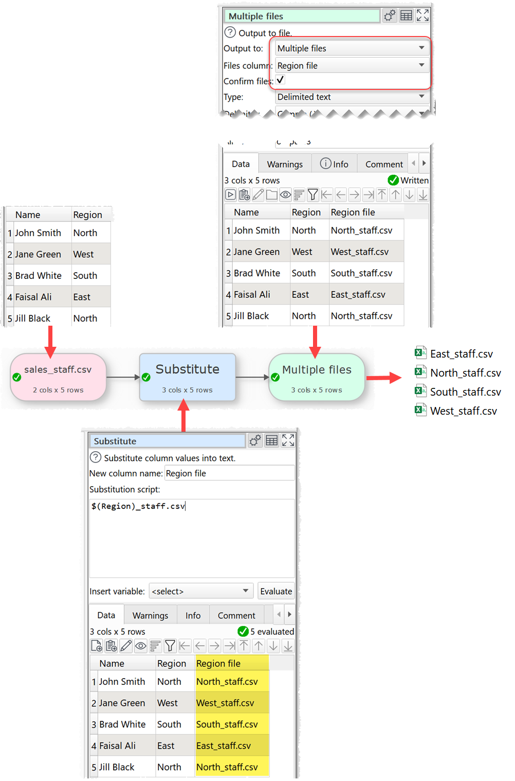

Example 2: Split according to row values
•Use transforms (such as Substitute) to create a column with the file location you want to output to, based on the Region column. The location can be an absolute location (e.g. c:\users\andy\output.csv) or a location relative to the .transform file location (e.g. results\output.csv). Folders output to must already exist. Empty or invalid values are ignored. This column is not output (use the Copy Cols transform if you want it to be).
•Create an output with Output to set to Multiple files and the Files column selected.
•Set Confirm files checked to be prompted before writing (recommended).

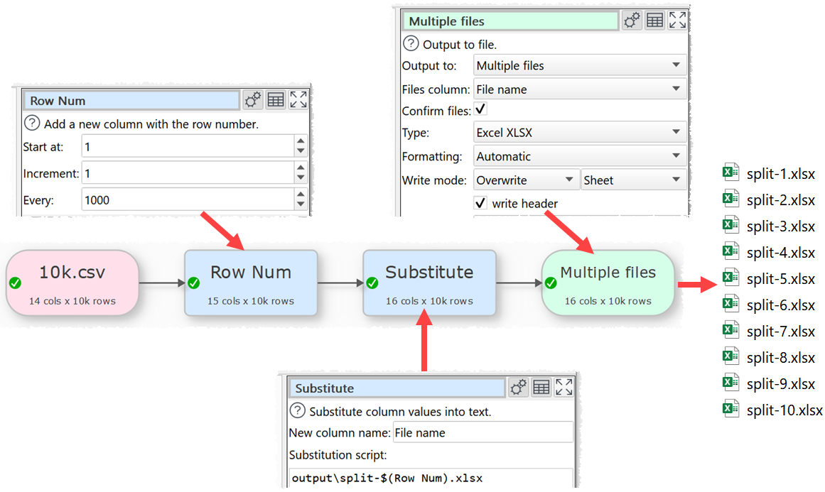

Example 3: Split by size
row file splitter
