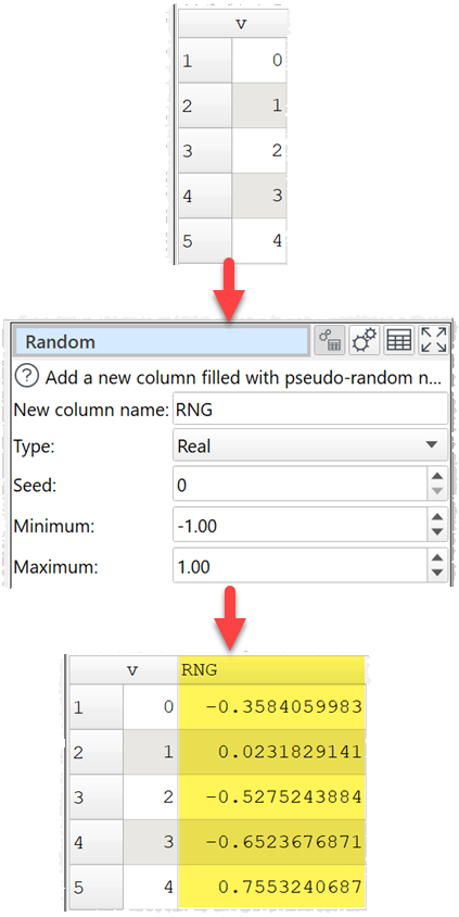

Add a new column of random real values between -1 and +1:
•Set Type depending on whether you wish to generate Real (floating point) or Integer (whole number) values.
•Set Seed to the seed value used by the pseudo-random generator algorithm.
•Set Minimum to the minimum value you want to generate. The value may be equal to minimum, but not less.
•Set Maximum to the maximum value you want to generate. The value may be equal to maximum, but not more.
•The numbers output are a sequence of pseudo-random numbers based on the Seed value.
