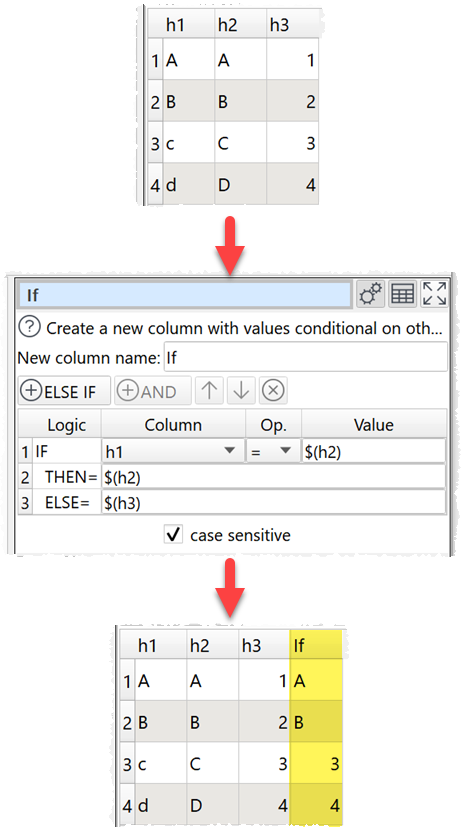

If the 'h1' and 'h2' columns have the same value then use the value of the 'h2' column, otherwise use the value of 'h3' column (using column variables).:
if-example-2
