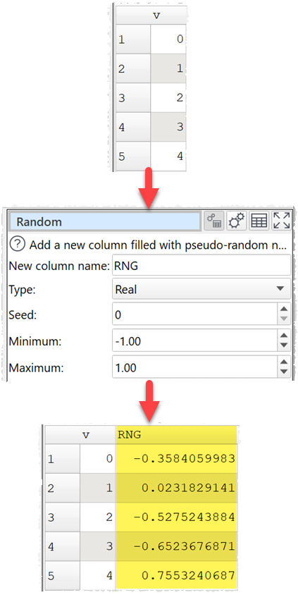

Adds a new column, filled with pseudo-random values.
Add a new column of random real values between -1 and +1:
pseudo-random number generator

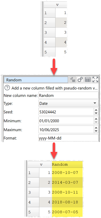

Add a new column of dates randomly chosen from 1st Jan 2000 and 10th June 2025 (inclusive):
pseudo-random date generator

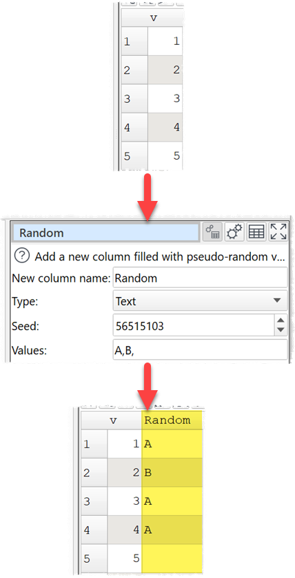

Add a new column of text values randomly chosen from 'A', 'B' or empty:
pseudo-random text generator

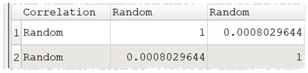

•You can use the Correlate transform to check sets of random numbers are not correlated. This show the very low correlation between 2 sets of 1,000,000 values between 0.0 and 1.0 generated by Random using seeds 0 and 1:
correlating pseudo random numbers
