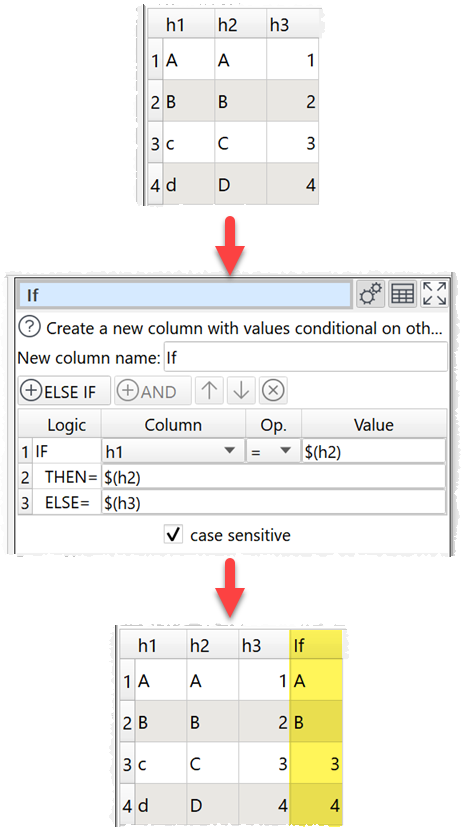

If the 'h1' and 'h2' columns have the same value then use the value of the 'h2' column, otherwise use the value of 'h3' column (using column variables).:

IF x = 1 OR y = 2
THEN 3
Is equivalent to:
IF x = 1
THEN 3
ELSE IF y = 2
THEN 3
