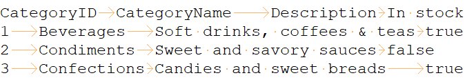

To output a TSV file you should set Delimiter to Tab (\t). You will usually also want to set Quoting to Never in the Right pane. If you have a Tab character or Carriage Return within a value, then Easy Data Transform will then convert it to a Space on output.
For example:
convert to csv
Is output with Delimiter set to Tab (\t) and Quoting set to Never as:
Tab separated value output
