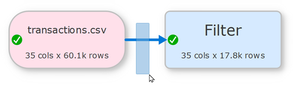

To select a connection
Click on the connection; or
Click and drag a box over any part of the connection. This may be easier than clicking the connection when you are zoomed back.
select-connection

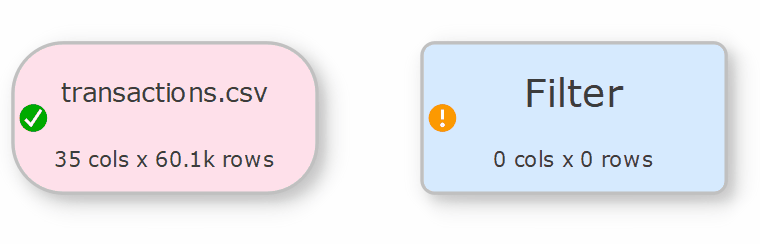

To add a connection
Hover over the start item.
Click the '+' that appears.
connection-start
Hover over the end item
connection-end
