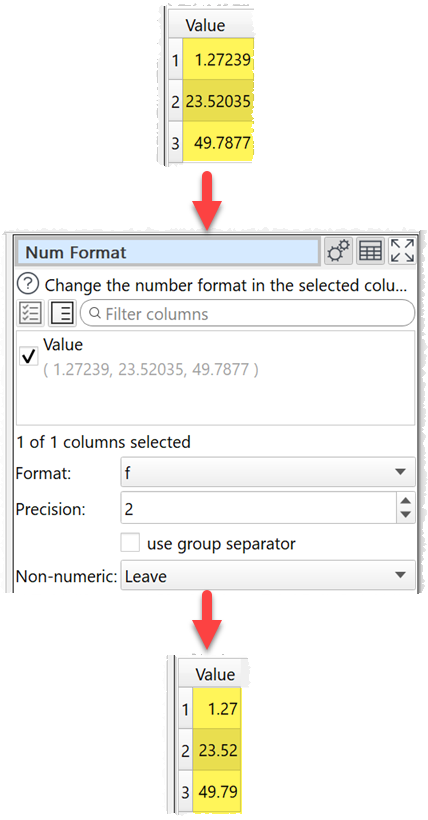

how to set the numeric format example

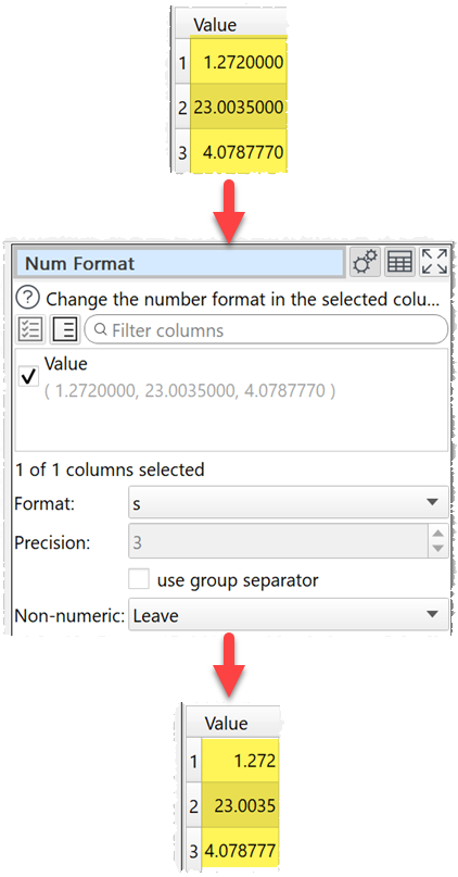

Set numeric to shortest accurate number
•Set Format to the new number format (see below).
•For the e, E, and f formats, Precision represents the number of digits after the decimal point. For the g and G formats, Precision represents the maximum number of significant digits (trailing zeros are omitted). For the s format Precision is ignored. The following number formats are supported:

e
Format as [-]9.9e[+|-]999.
E.g. 1234567.89 is shown as 1.235e+06.
E
Format as [-]9.9E[+|-]999.
E.g. 1234567.89 is shown as 1.235E+06.
f
Format as [-]9.9.
E.g. 1234567.89 is shown as 1234567.89.

s
The shortest accurate representation for the given number without exponents.
E.g. 1234567.00 is shown as 1234567.
