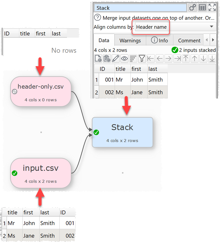

If columns are in different orders in different input files (e.g. the "ID" column in the first column in input 1 and the last column in input 2) you need to sort the input columns into a standard order before applying other transforms. You can so this using the Stack transform with Align columns by set to Header name. Stack your input under a dataset with just the columns in the correct order.
