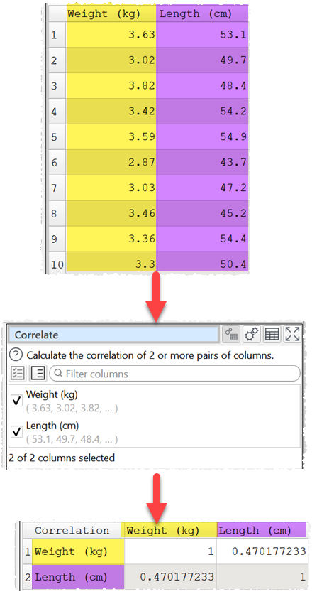

Calculate the correlation between specimen weight and length:
Pearson correlation example
