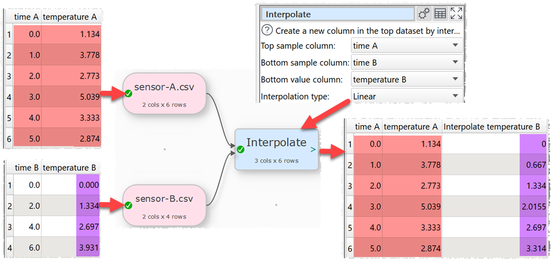

Interpolate values  based on numerical samples in the top upstream dataset (by vertical position) and values in the bottom upstream dataset.
Interpolate time and temperature datasets for sensors A and B with different sampling frequencies:
how to interpolate 2 datasets example
Place the dataset you want to modify as the top input and the dataset you want to sample values from as the bottom input.
Uncheck automatic new column name to set a name for the newly created column in New column name.
Select Top sample column for the column whose values you wish to sample.
Select Bottom sample column for the column that matches the top sample column in the bottom dataset.
Set Interpolation type to the type of interpolation you wish to use.
piecewise-interpolation
linear-interpolation
If your sample is below the first sample in the bottom dataset, the first value will be returned.
If your sample is above the last sample in the bottom dataset, the last value will be returned.
Easy Data Transform will try to guess sensible default values for Top sample column, Bottom sample column and Bottom value column based on column contents.
Messages are shown in the Warnings tab for non-numeric values in either dataset.
Messages are shown in the Info tab for Top sample column outside the range of values in Bottom sample column .
